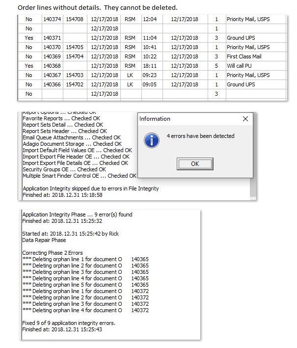

We are running into data integrity problems after updating OE 9.3A with the 181214 update. This problem did not exist until the recent update. If we re-open an order and add or subtract lines, the order will complete properly but another version of the order can overwrite a different order. The order that is now overwritten has no order # and it cannot be opened for inspection or deleted. Data integrity checking stops and a backup must be restored in many cases. Other errors can be repaired and it reports orphan lines. We are using AR 9.2A at this time because of the credit card issues. The release notes show that AR 9.2A is compatible with the OE update.
With a test computer with Adagio with AR 9.3A, when we repeat the steps that caused problems, the data stays clean and the errors don't happen. Are there any problems with using AR 9.2A showing up yet? The update was installed a second time to see if the problems went away but no luck.

OE 9.3A 181214 Problems.jpg (42 downloads)
Description: OE 9.3A problems with 181214 update installed
