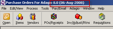

What is the version of POA that you are using? This information can be found in the menu bar of POA. For example, I've attached a screenshot from my version of POA - "8.0 (06-Aug-2008)"

Fong if you upgrade your POA to the lastest version you shouldn't have that problem anymore. The latest version POA VER 8, (06 AUG, 2008) seems to have corrected that problem with "ghosts" since I upgraded.
