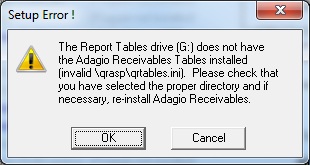

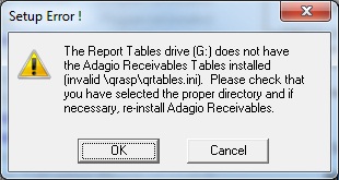

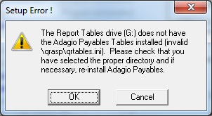

Hi I'm having some issues installing Adagio (Any Module) on my workstations. I thought it might have been a Windows 7 issue but I tried on a Windows XP SP2 computer and I'm getting the same errors.
I have run the CheckSys and it found some problems to do with QRTABLES. I have attached the LOG from CheckSys and the screen shots of some the errors I'm getting.

If you are installing Adagio on a new workstation, you must make sure that the drive mappings for the workstation are the same as the others. The directory \QRASP (the report tables folder) must exist under the root directory of the same drive letter on all Adagio workstations.

Ensure that whoever is doing the installation has full rights to write to the \QRASP directory. The list of expected report tables is out of synch with what is found in the QRASP directory.
If the problem is that the qrtables.ini file is incomplete, the only solution is to reinstall the Adagio program.
You may need to location the 'Date Fixer' utility in case some system files have become mis-dated due to a known problem with MS Server.

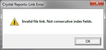

The last install I did was Crystal for Adagio.
It was a fresh install from my workstation, for my workstation. This might have to do with the problems I am having...
Crystal does work at the moment but I still have the age old issues where the LINKS between tables do not work properly... see attachment.
If reinstalling the Ledger, the Receivables and the Payables does not do it, I'm not sure what will.
It might be time to call our Adagio consultant...

I resolve the issue I was having so I thought I'd take a minute and post the solution to my problem.
After running into these issues with some of the INI files, I reinstall payables, then receivables, then ledger and the issue went away.
My Softrak consultant did say that it must have been caused by the Crystal install that I had done. The Crystal Install is quiet old and must have overwritten some newer files.
Anyway, the reinstall of each of the module was done from a workstation onto the Share on the server.
Thanks to everyone who helped.

Indeed if Crystal Reports was installed, that would wipe out some settings and require re-installations of Adagio. Should you need to do re-installing (Crystal Reports) again, there are some steps that could be done to backup files prior to installing, and then restore after installing, to prevent what happened.
