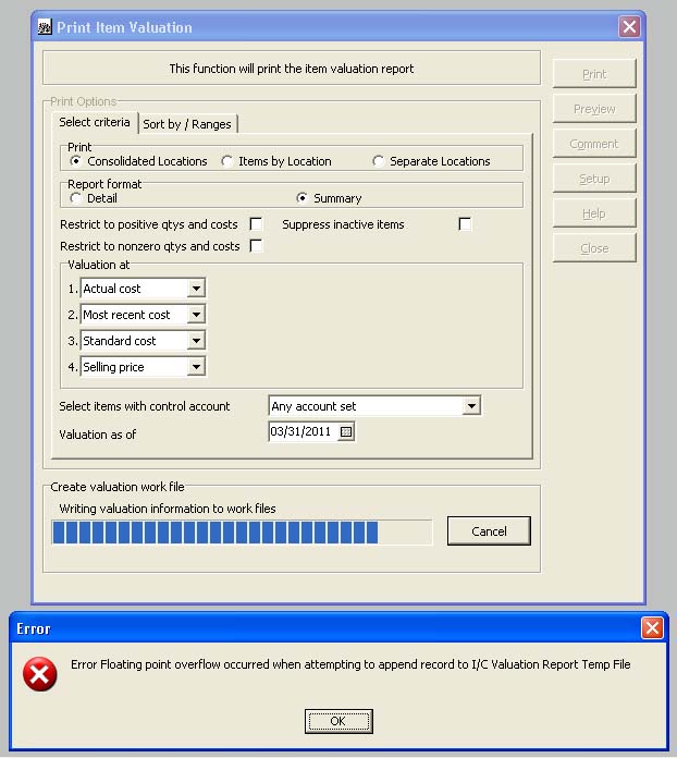

Since the Service Pack to IC 8.1C (110713), the Item Valuation Report is giving us an error.
"Error Floating point overflow occured when attempting to append record to I/C Valuation Report Temp File".
See .jpg attached.
Item Valuation.jpg (108 downloads)

Hi, Susan,
Have you checked to ensure that data passes integrity? If not, please do.
I notice that you are printing a backdated Summary report. Do you receive the same error (or another) when printing a Detail report or when using today's date.
Also, I only see one of the two print window tabs in your screenshot. Are there any values in the Sort by and Location from/to range fields (other than 'blank' thru Z's) on the Sort by/Ranges tab? If so, what happens if you change the range values to, say, another item or location or to the complete range?

Integrity check runs through without errors.
The error only occurs when I date it back to March 31, 2011 which is the last day of our last fiscal year. After the error, the report completes, however, it's showing almost $20,000 in residual costs, that I know for sure was not there as of March 31, 2011.
Sort by item number starting at first and ending at the last item.
