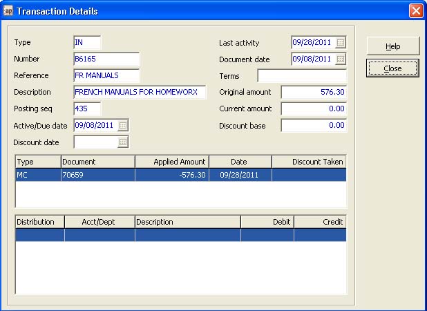

We are looking at a few of our vendors history and trying to figure out how it's possible that the account details are missing. After looking further we realize it has affected all the Vendors who were combined with Toolkit. I've attached a screen shot.
By the way, we wouldn't have required using Toolkit at all if there was a drop down menu for Report Groups in AP. Since there isn't, we use Control Accounts instead and since it's impossible to change a Control Account in AP, the only work around we've come up with is creating a new account and using Tool Kit to combine into. We've done this to dozens of accounts. Now to find out we've lost all our details in history as a result... not good!

Hi Susan,
I'll have to investigate further. Perhaps the problem is combining vendors with different control accounts or something unrelated. It would be better, if I was testing with a backup of your data...made by the Toolkit, prior to the changes. I'll also need to review what was done and when. That can be coordinated on email.

Hi Susan,
I was able to reproduce the problem you experienced, merging vendors. When you combined Vendor A into Vendor B, you might have lost some of Vendor A's G/L disbursements for merged transactions. Keep in mind that these G/L disbursements are only for drilldown or reference. They aren't the actual G/L transactions. All posted transactions should have been merged.
This problem applies to merging vendors, not changing them. Combining Vendors with different control accounts, did not make the task any harder. It's still supported. That said, control accounts typically have different G/L accounts, so that change should be considered.
AP and DataCare are capable of detecting orphaned G/L disbursements, so a DIC/rebuild, might have removed them.
I'll have a new build of the Toolkit, later today. I'll send you (and Toolkit dealers) a link download the fix.
