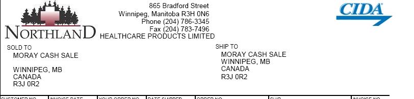

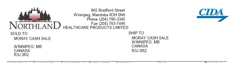

When I print an Invoice, confirmation, picking slip for one particular computer, everything is moved to the top and to the left. It does this on any printer including Adagio PDF. Only one machine is doing this, 30 computers print the same specifications properly. Printing reports is Sales Analysis is fine. I have attached a sample of a correct print and the incorrect print. Any suggestion would be appreciated.
