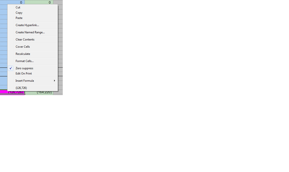

When trying to drill down to G/L details there is no option in the pop-up menu to select Details or Tx Details. I'm assuming we are an upgrade (or 2) behind but would like to confirm.

If it is a financial statement you are referring to, try double clicking on the amount.
#37749 - 07/09/13 01:23 PM Re: Drill down pop-up menu [Re: CHFManitoba]
(24.84.56.24)
You have to have selected a single cell that contains a number that can be "drilled into". Check your selection.

I have tried that and it will just give a formula
Here is the formula in an example cell:
=-SUM(ADGET("gldata.BAL",$A10))

I've done that as well and I've also checked the Adagio Manual and the cell I have selected does contain a function listed in order to drill down.
Here is an example formula =-SUM(ADGET("gldata.BAL",$A10))
According to the Adagio manual Pag 3-93 If you have the function of ADGET you should be able to drill down.
Does it have something to do with the version of Adagio we have?
#37754 - 07/09/13 02:03 PM Re: Drill down pop-up menu [Re: CHFManitoba]
It's the SUM part that is preventing the drill-down.
You probably don't need SUM based on what the rest of the formula contents are, and may be able to use =-ADGET("gldata.BAL",$A10) to show the negative balance of the account(s) in cell A10 as of the selected fiscal period and year.

That was the problem! Thank you! I've switched the formula from
=SUM(ADGET("gldata.B",$A8)) to =-ADGET("gldata.BAL",$A8) and the Drill down function is now working perfectly!
