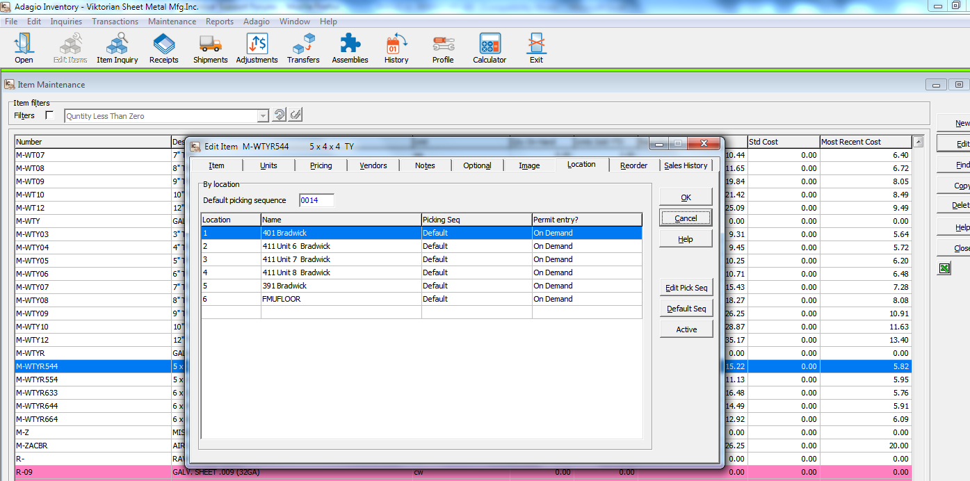

Perhaps by 'on demand', you meant items that have not yet been made 'active' at a location? Editing items and looking at the Locations tab shows the text 'On demand' in the 'Permit entry?' column if the item is not yet active at a location. Items not yet active at a location is different than a non-stock item, which means the 'stock item' option on the item is disabled.
If you can clarify specifically what you mean by 'on demand' with an example, that would give us a better chance to address any problems.

3. On Demand shows for locations where an item is not active.

The first dozen items that were missing all had a default picking sequence defined but were showing on demand (inactive) at all locations. Not sure how this happened but I suspect that it was when we transferred inventory over from the old accounting system. I'm going to check the rest of inventory to be sure but I think that's the problem.

I believe I was able to replicate the problem. I created a brand new item from scratch, and did not make it active at any location. Naturally the qty on hand is zero. When I choose 'All items' for the worksheet and also include the option 'Suppress 0 qty items', this new item does not print on the worksheet report, but it is included in the export file, incorrectly. This should be fixed.
If I make the item active at the location, then it properly gets suppressed from the export.
When an item is On Demand at a location, it means there is no record in the item location file for that item/location combination. So GridView can't be used to search for a data value there. Looks like you got something that works for GV?

The easiest way to re-create it is to create a new item by copying an existing item. The new item will have the originals' default picking sequence but will show on demand for all locations. It can be fixed by selecting the activate button. I think importing an adjustment file with a positive and negative quantity for each item is the easiest way to fix it, unless you have a better idea?
