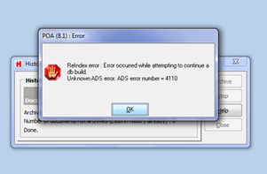

Every time I complete a Day End in PO's and Archive I'm getting an error number 4110.
This started last Thursday and I complete a day end each day.
Can you tell me why this is happening???
Error Pop-up Box attached:
po error.PNG (104 downloads)
Edited by Heather Mac (04/07/15 07:57 AM)

That's a screen shot from a VERY old version of Purchase Orders for Adagio. You are on Upgrade Plans and have the current version available.
Perhaps it is time to ask you Adagio Consultant to drop by and get your modules current? You'll notice a large number of improvements in PO processing and much greater stability in the product.
It's possible your data is damaged - does it pass the Data Integrity Check?
