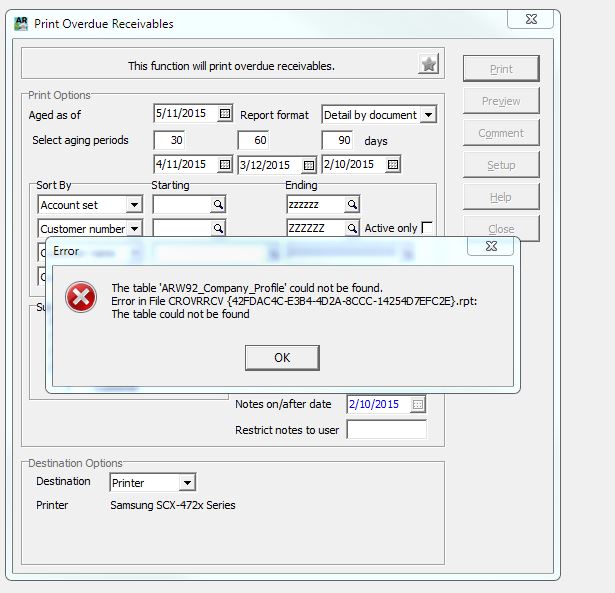

I'm getting errors in all of my modules since I did the upgrade on Friday. I can't print or preview any reports in any of the modules. All of the errors are similar to the one attached.

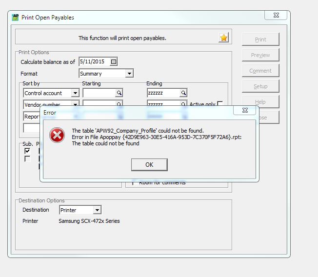

AR & AP errors...
AR error.JPG (143 downloads)
AP error.JPG (125 downloads)

It was installed to a network drive via the server computer so Administrative rights were okay. OS is Windows 7 so that shouldn't be an issue either. Seems to be some issue with the crystal reports because it occurs every time I try to run any type of report. I'll try re-installing all of the modules to see if maybe there was an error in the install...nothing had seemed out of the ordinary though when I did the installs in the first place.

Without knowing what the error(s) received were after the upgrade, it's almost impossible to help. The errors I'm referring to might be received during the install, or when running the program, or when printing a report. Or, it might be describing the state of the print window when trying to print a report.
Knowing what the exact error received is imperative. In v9.2, knowing whether the User Preferences report prints or not is also imperative. While the report also uses the new Crystal, unlike the other reports, it does not require that a connection to the AdagioODBC runtime also be made.
