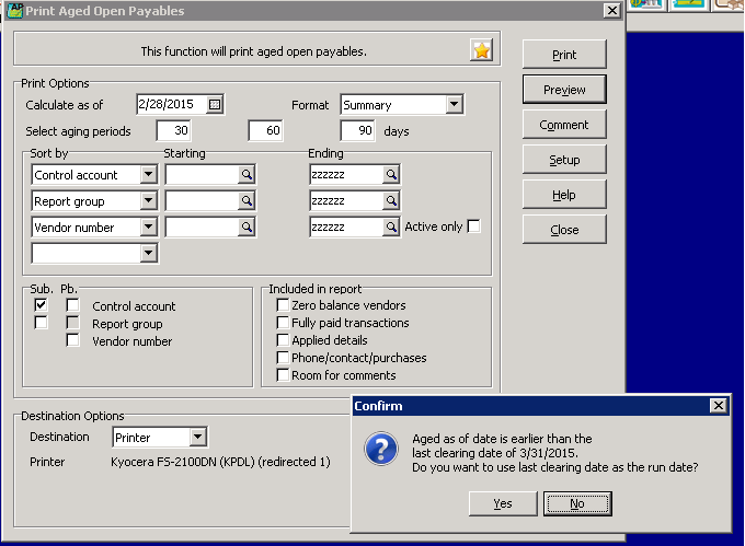

#45870 - 05/26/15 05:08 PM Re: AP9.2A(150310) Calculate as of [Re: Retired_Guy]
MarlonMF Offline
Adagio Guru
Registered: 06/05/07
Posts: 126
Loc: Los Angeles, CA
Hello Andrew,
My last clearing date was 03/31/2015. I'm running a report (Aged Open Payables) Calculated as of 02/28/2015 and I get a restriction. Please see screenshot.
Is there a check box I need to marked to get this restriction off?
Marlon

#46144 - 06/10/15 02:54 PM Re: AP9.2A(150310) Calculate as of [Re: MarlonMF]
Hello Marlon,
The Payables 92A (150609) Service Pack has these updates to the Aging reports:
- The Aged Open Payables report can be printed if the ‘Calculate as of’ date used is earlier than the last clearing date
- The Aged Overdue Payables report will report transactions that were in history.
