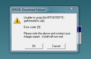

When I try to install this hot fix I get the attached download failure error. What did I do??
Jean

#46916 - 08/18/15 03:27 PM Re: GL posting - extra line [Re: JeanB]
Download the Hot Fix again and run the EXE from File Explorer. Do not run the EXE directly.

Still getting the same error message. It's right at the beginning of the process when I click proceed. A small window pops up saying "downloading file" and then I immediately get the error. I've re-downloaded it about a dozen times and I'm running the EXE file directly from windows explorer.

Problem resolved. I went back to the very first EXE file I downloaded and it worked this time around...for some reason through only the original download worked. (Not sure why it didn't work yesterday though.)
