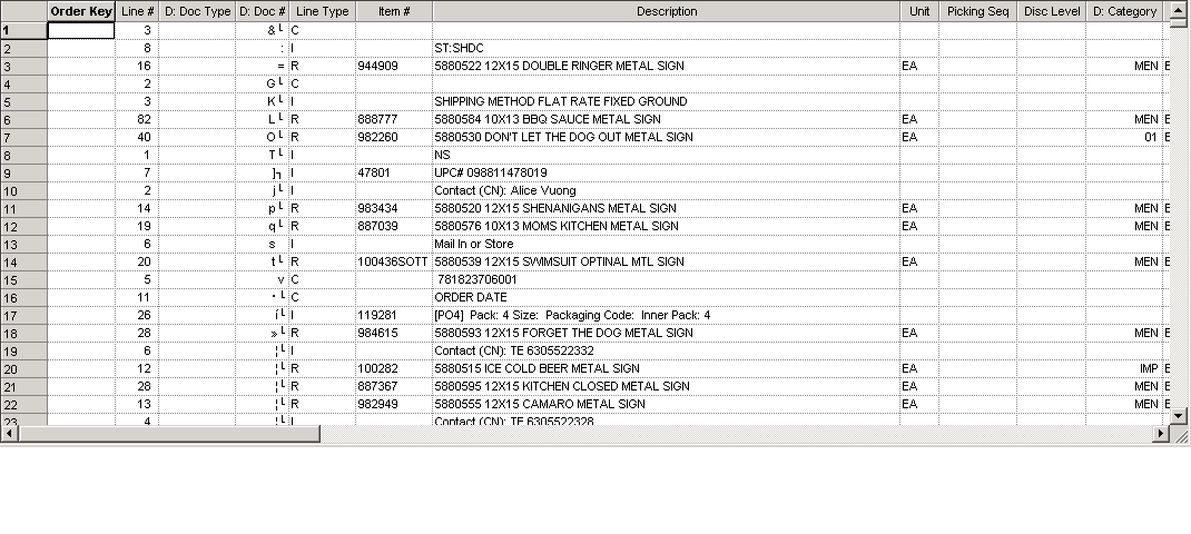

I have a problem with my Sale Order Details. I run data integrity and in found 1000+ orphan records with gibberish document number. When I rebuild it, it says ophan line deleted but when I run data integrity check again and finds those same lines.
I open the data in GridView and I can see a lot of line items that have gibberish in either document number or order key. I tried deleting the lines from GridView but nothing happens. It is as if it is ready only.
If I delete regular line (Lines with no gibberish) it deletes fine.
Attached screenshot from GridView with first few lines that have a gibberish document number.
