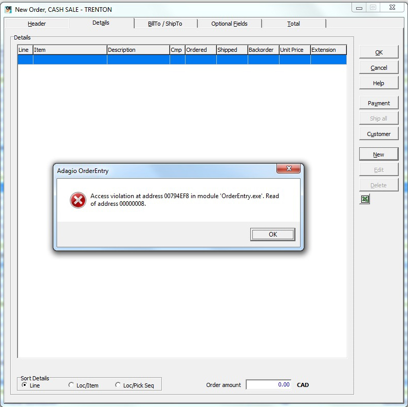

I installed the OE 9.2A (2015.07.29) upgrade the other day and ever since we have been experiencing Access Violation errors. One of our staff figured out how it happens.
"In OE, when I search for either a customer or an item, I hit F6 to bring up the search window, type something in and hit escape (without actually searching), the error pops up every time".
Screen shot attached.
adagio oe error.jpg (163 downloads)

Hi, Susan,
Yes, I can duplicate this and am reporting to R&D for you. Thanks for bringing it to our attention.

This was fixed in the OE 92A (160111) SP.
