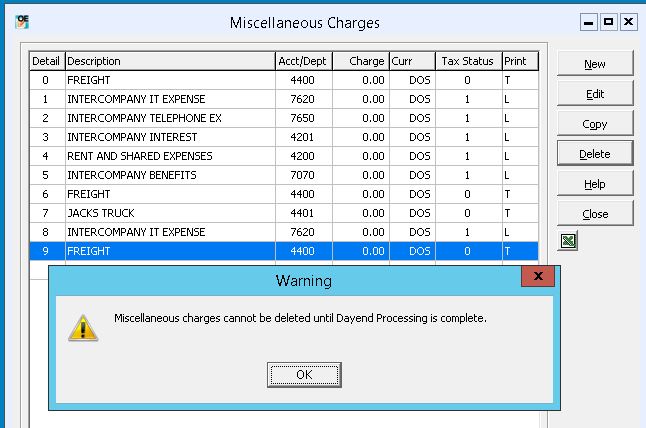

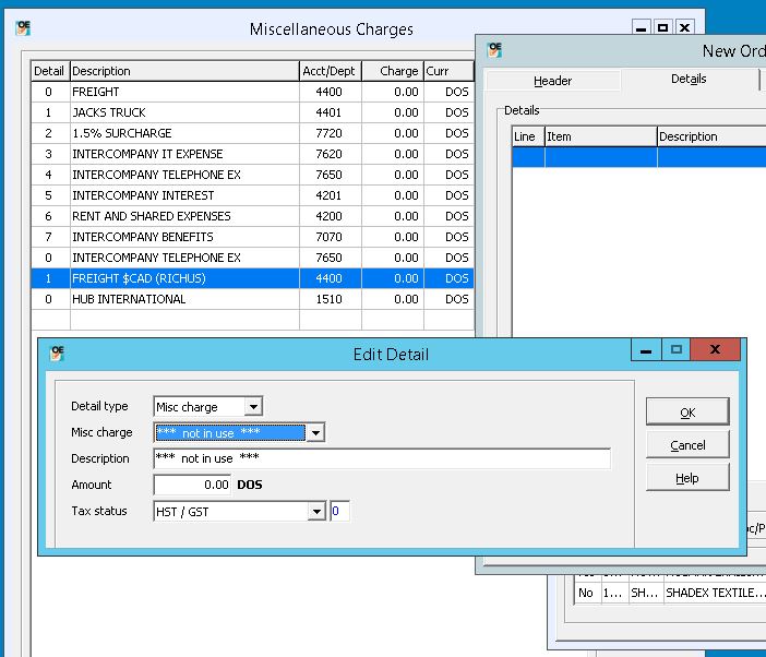

When trying to add misc charges getting no misc charges to select from.
Please review the attached and advise what might be wrong.
Still can not delete misc charges after day end.
Regards
Victor
OE Misc Charge.JPG (179 downloads)
OE MC delete error.JPG (195 downloads)

#49745 - 04/25/16 09:53 AM Re: OE 9.2A Misc. charge ***not in use*** problem [Re: Victor B.]
Posts: 4543
(96.227.71.10)
Hi Victor
You probably need to go into OrderEntry | Edit Company Profile | Processing Options, and make sure the option "Misc. charges from main list" is checked.
#49746 - 04/25/16 10:12 AM Re: OE 9.2A Misc. charge ***not in use*** problem [Re: Steve Schwartz]
Bob Wisener Offline
Adagio Conductor
Registered: 03/19/02
Posts: 567
(50.68.160.191)
The price list and currency code may also restrict what you see.

#49747 - 04/25/16 10:35 AM Re: OE 9.2A Misc. charge ***not in use*** problem [Re: Bob Wisener]
Victor B. Offline
Registered: 05/07/06
Posts: 97
Loc: Toronto, ON, Canada
(173.246.159.30)
Hi Steve,
Thank you.
"Misc. charges from main list" were checked.
Customer currency and misc charge currency are the same.
Customer has existent APL in the same currency. How all components should be configured?

#49789 - 04/26/16 11:11 AM Re: OE 9.2A Misc. charge ***not in use*** problem [Re: Victor B.]
Victor:
By default only those orders/invoices up to and including the system date are included in a day end.
If you have future dated invoices they will not be included.

#49812 - 04/26/16 07:59 PM Re: OE 9.2A Misc. charge ***not in use*** problem [Re: Victor B.]
Posts: 3646
(174.88.173.174)
Victor:
Now that you have a full Day End, you should be able to delete the Miscellaneous Charge.
The "***not is use***" message is a separate issue. Did you do as Steve suggested and also look to see if Bob's considerations apply in your case?
#49838 - 04/29/16 08:12 AM Re: OE 9.2A Misc. charge ***not in use*** problem [Re: Bruce Gardner]
Victor B. Offline
Posts: 97
(173.246.159.30)
Hi Bruce,
Thank you for your reply.
After I completed full Day end I was able to delete the Miscellaneous Charge.
I created APL with one item for customer and use it in misc. charge. The "***not is use***" message disappeared. And I was able to select any misc charge from the list.
