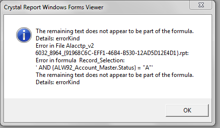

Loc: AL
Error previewing chart of accounts. "The remaining text does not appear to be part of the formula. Details: errorKind
Error in file Alacctp_v2 - remainder of error in attachment.
If sent to printer, returns no error and nothing goes to printer.
#52745 - 02/20/17 08:11 AM Re: GLChart of Accounts Error GL9.2B (160910) [Re: doswalt]
Hi David,
We are aware of the problem. It will be fixed in an upcoming Service Pack to Ledger.
Sorry for the inconvenience.
#52773 - 02/21/17 02:08 PM Re: GLChart of Accounts Error GL9.2B (160910) [Re: Retired_Guy]
This has been fixed in the Ledger 9.2B (170218) Service Pack.
