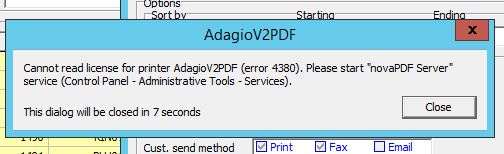

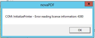

In my scenario NovaPDF server is not found in services
Please see pics attached
How to properly re-install NovaPDF server ?

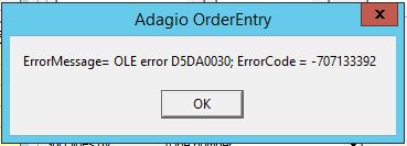

Pretty sure this is the same site, yes? Something has changed. You were not reporting these OLE errors previously. I believe those are different than what’s been reported by any other site.
