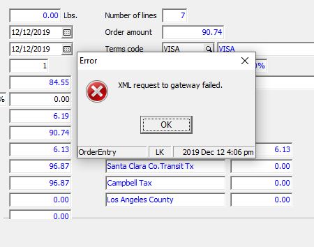

We recently installed Adagio Payments and have had a problem on one computer only after we started using it to process credit cards. On our peer-to-peer server, it will complete a payment but then will not process another without getting an error message of "XML request to gateway failed". If the OE module only is closed and re-opened another payment can be processed. AR can remain open. This is not an intermittent problem. Only one payment can be processed, then the OE module must be closed & re-opened before another payment can be processed. Workstations on the network do not have this problem.
We are using OE 9.3a 191125, AR 9.3a 190821 & Adagio Payments 9.3.0.1 20180624.
Has anyone seen this problem and found a cause or a solution?

XML Error Message.JPG (100 downloads)
Description: XML Error Message

Just want to thank Rick for his time yesterday afternoon working with us to fully determine his process and, from that, the cause of the issue.
Turns out the problem occurs when Direct is being used as the email method by a user. R&D is on this but the fix is complex and will take a while.
In the meantime, options are to use MAPI/Outlook settings or to continue with Direct and send the emails to the email queue to be sent later using the Send All button.
Again, thanks for your time on this Rick.
