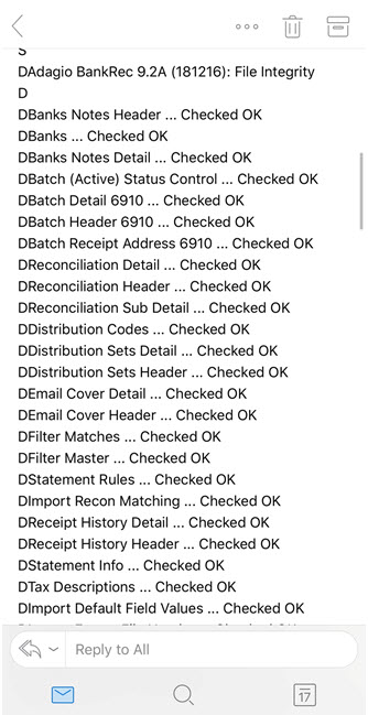

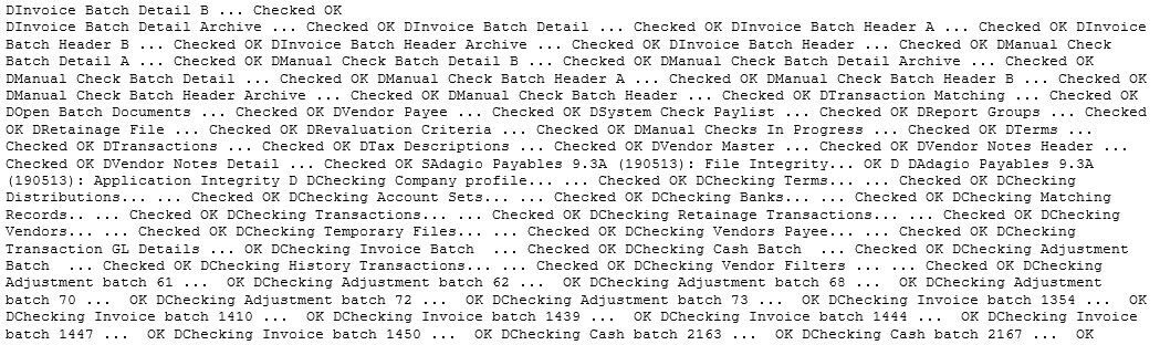

I recently updated a site to Datacare 9.3A and afterwards the formatting of the e-mail reports has changed, making it more difficult to read. Ds and Ss have been added to all the rows of the output, and line breaks have disappeared in the body of the message. I've scoured the settings and can't seem to find anything that would have changed, have tried the new Summary with Detail option, all with the same result. I'm not sure if this is a change in DC or if it's the way the GMail server is interpreting the direct email. I've included a small sample of what the top of the emails were like, and what they're like now. Anyone experienced this?

EDIT: I should add, when viewing on a mobile device in the Outlook App there is formatting, the only change was the Ds and Ss and some line duplication. I've attached an image of the detail section of the report from both my Outlook PC and iOS apps.
Outlook iOS App.jpg (52 downloads)
Outlook PC App.jpg (71 downloads)
