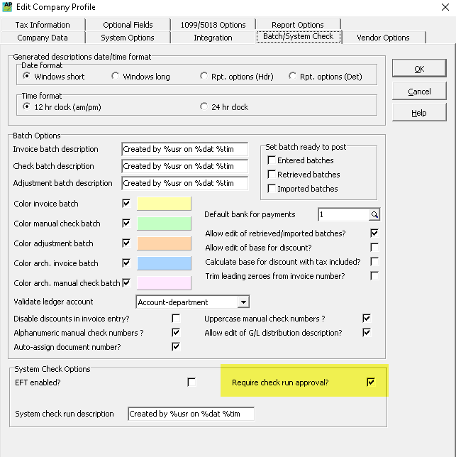

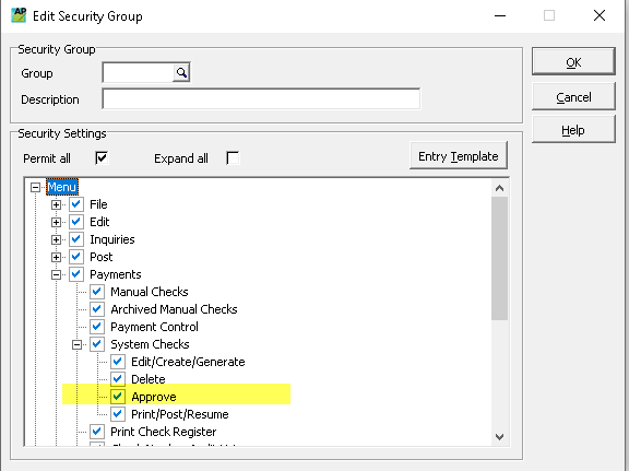

I had one site perform the upgrade themselves and reached out with a similar problem with their System Check Runs.
In their case, the new approval option was causing them issues. It's enabled/disabled in the Company Profile, and then you also need to allow the approving user the ability in the security group.
I've attached some screen shots, hope that helps.
Jesse

Are you talking about the "require check run approval" option in Batch/System Check tab? That one is unchecked...
I've also gone in and made sure that her security allows all functions in Adagio.
