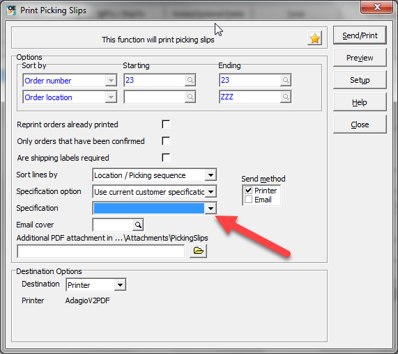

I must be missing something obvious. This is not new.
Default Picking slip is denoted in OE Company Profile.
The User Preferences "Remember form settings" is checked.
The Customer record on the Invoicing Tab has the Picking Slip they use in their record selected.
Yet each time we post an order and go to print the picking slip we always have to pick out the specification as shown in the attached picture - yes I figured it out on how to attach a file!!
OE Pick Slip Spec Field.png (96 downloads)

If you are printing picking slips or any other document type in OrderEntry with the 'Use Current Customer specification' setting, it will not load the customer spec into that screen. It is OK that the field is blank - when using the 'Customer spec' option, the spec on screen is only used as a fallback if there is no defined spec on the customer record and the Invoicing tab. Simply print the picking slip, and if there is a spec set on the customer, it will be used.
FYI if you want to assign a default spec when printing, it is done from the File / Workstation Options area, in the same place that default printers are set.

Thanks support the Workstation Options did the trick.
