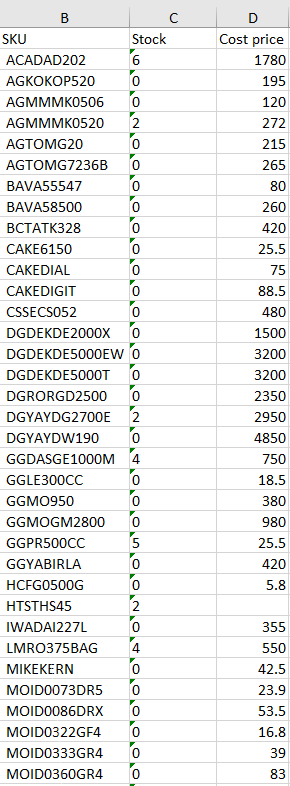

Hi, I’m wondering if I could extract only specific product SKUs out of the entire database and print a report for only specific items based on their exact product SKUs and in the order that I require them to be in, every single time?
It would be great if this function could be saved so every time I needed to reprint the report with updated quantity/cost, it could be done again with just a click.
The report would have a heading like this:
| Product SKU (in the order I want FIXED) | Stock (quantity on hand) | Cost Price |
Or refer to the PNG file I uploaded.
Note that I do understand that ‘Quick Reports’ allows you to extract items based on their stock, date and many other variables, but I currently only need to look at fixed items rather than my whole database, and also in the order that I require them to be viewed in.
Thanks in advance. Best regards.
Edit: I am using Adagio IC, and by “SKU” I meant “item number” in Adagio, which refers to my product unique identifier. Hope that makes it clearer
Description: Would be great if out of the tens of thousands of SKUs in the database, I only want to extract the report of the specific 2000-3000 items in one click, daily.

Hi Lee
The answer is yes.
Since you are my client, email me this question and I will answer it in detail - steve@sschwartzcpa.com.
You don't own Adagio GridView, which is the program that would meet your exact request. GridView is sort of like the Adagio equivalent of Quik Reports, and it has the ability to automatically send the output to Excel.
