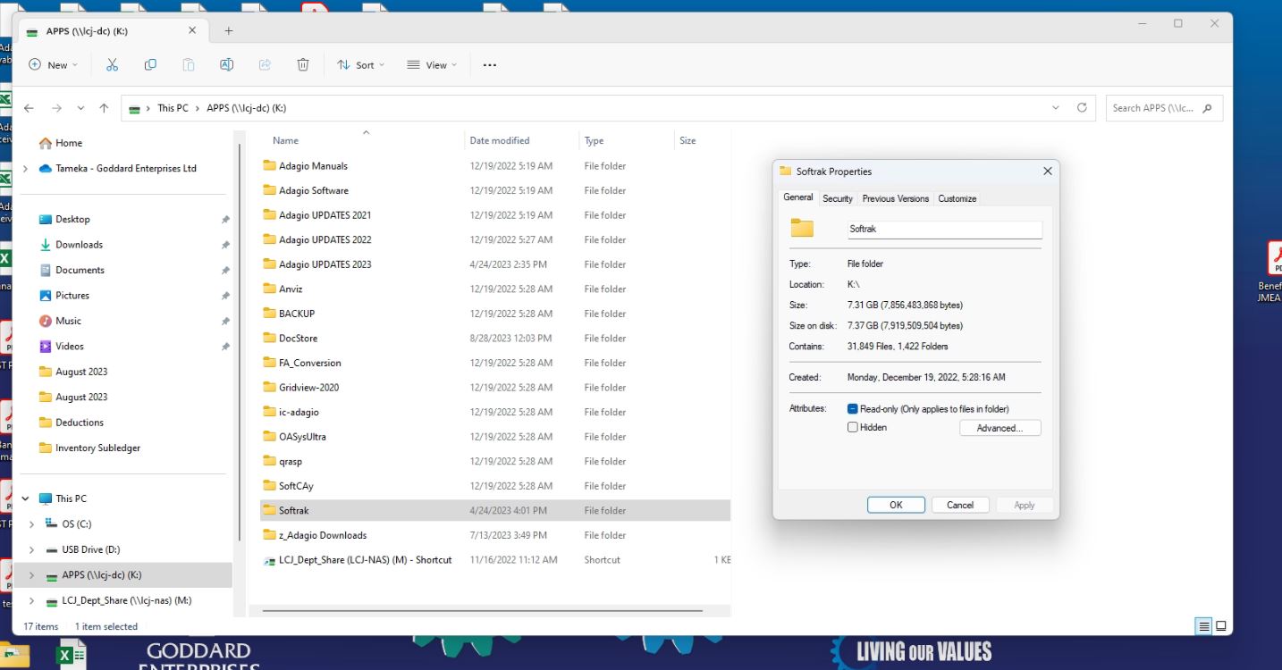

Today, download and begin upgrade first module is ledger after input codes doing Standard Install I get this error (Destination Selection Error )
Message= The following chosen folder is not write-enabled
(K:\Softrak\Ledger)
Please choose again
I spoke to network admin he made sure all is OK on SERVER - ( Still No go)
I then took a look at K:\Softrak folder using File Explorer O/s (Windows 11 Pro)
I see the following attributes (see attached file) Its an international firm, with off shore administrator, so I can not go fudging around with local computer...

The user profile no longer has full rights to the folder. Their IT will have to change it back for that user if you want to install updates.

Edward contacted me directly and I advised him that I've seen that message when using the newer Adagio installs and/or installing on newer OSes when using mapped or substituted drives. I advised him to use the UNC equivalent for the install path and all was well.
The mapped drives still run the apps fine but have issues with the Adagio Installs on some machines and giving misleading messages like the one above. Why I have no idea but as soon as I have an issue with the mapped/substituted drive during an install, I just use the UNC path and so far so good. That is, of course, assuming that the network/folder rights are actually OK ... but especially in the case of upgrading where the site has been happily using (which also requires write access) Adagio then in most cases the rights would not have suddenly changed when you go to upgrade - not sure why the screen shot seemed to suggest that files in the folder were read-only.
