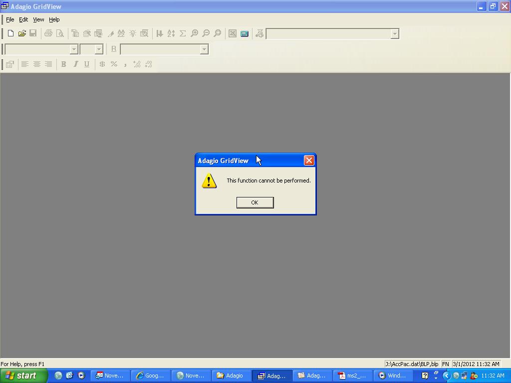

While trying to create an inquiry in GridView, I ran into another issue: when performing File, New I am getting the "This function cannot be performed" error (see attached screenshot).
Can you suggest what may cause this issue?
Thank you for your assistance.

Your security permissions do not allow you to create a new GridView View. Review the documentation and verify that the correct parameters are on the shortcut. If you want to create a new View, you must launch GridView from a shortcut.
