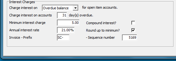

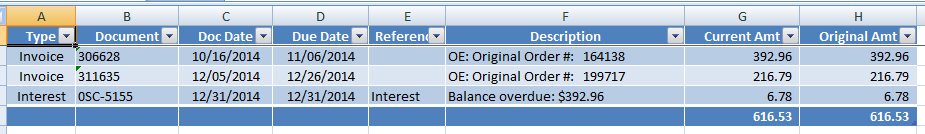

#44018 - 01/02/15 12:57 PM AR Interest Calculation
How does AR calculate interest? Our Company Profile is set up to charge interest on Overdue balance 31 days overdue at 21% annually (screen shot attached).
Yet a customer with an overdue balance of $392.96 was charged $6.78 interest. (screen shot attached).
My calculations are $392.96 x 1.75% = $6.88. How is AR coming to $6.78?

Susan:
You need to include a screen shot of your Create Interest Batch dialogue plus let us know when was the last time you created an interest batch. I can come up with $6.78 by;
$392.96 x 21% / 365 days in year x 30 days in November = $6.78
#44022 - 01/03/15 12:10 PM Re: AR Interest Calculation [Re: Douglas Dickie]
You got it.. thanks!
