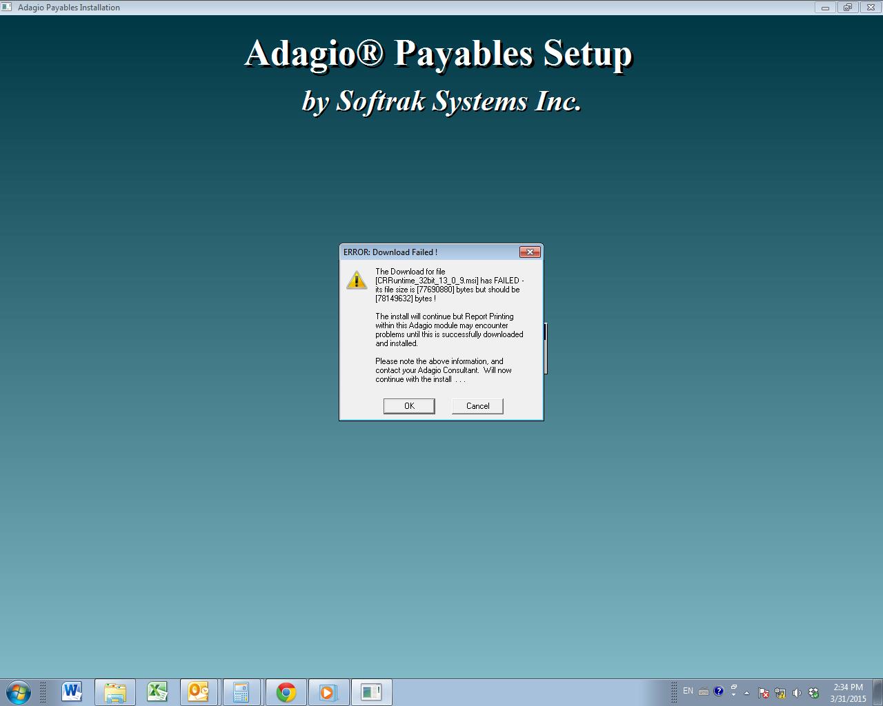

Hi, I was updating Adagio Payables 9.2A and there was a problem downloading the Crystal (something something) file. I've attached the message it displayed.
Please help!

The message you received in your first post indicates that the CRRuntime file is corrupt. This is usually a result of a very slow download. The install should have already renamed the bad file. The rest of the install is probably fine.
Try the install again and, if the connection is faster this time, all should go well. If not, let us know.

You can download a ZIP of the CRRuntime file from here manually and unzip it into the x:\SOFTRAK\system\CR_InstallCommon Folder, then rerun the install to see if that resolves the problem.
I understand why you are grumpy about this Upgrade not going smoothly. In our defense, our Release Note classifies the Upgrade as "Difficult", so I'm a bit surprised you would install it just prior to completing your month end. Of course, perhaps this just speaks to the good job we've done with earlier Upgrades. Unfortunately, this component is delivered from other company's web sites.
