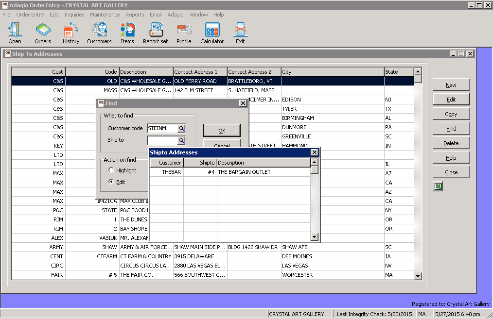

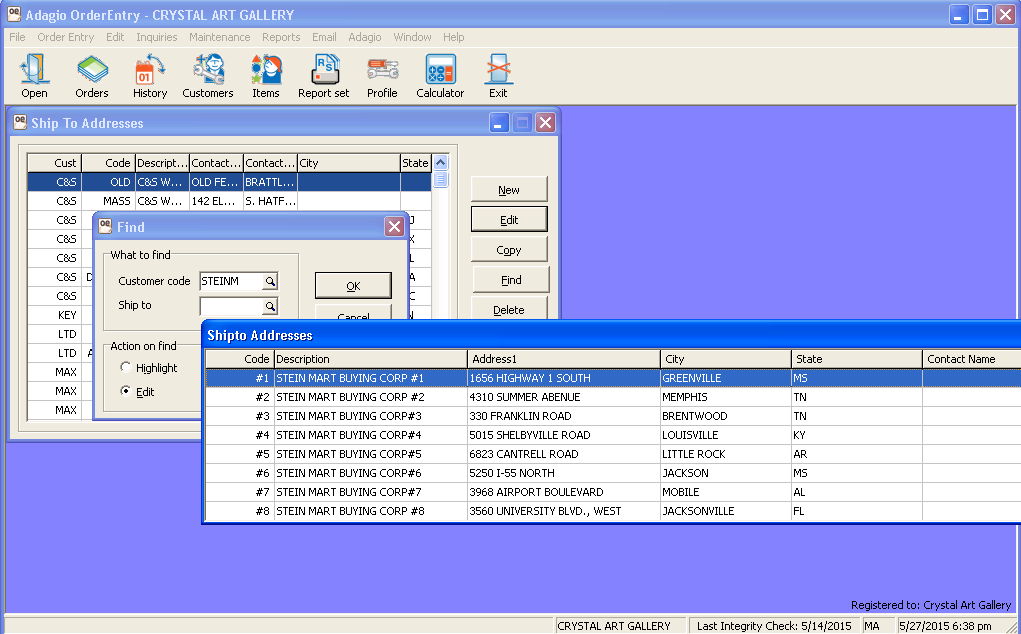

In Adagio OE8.1F (150227) Ship To Addresses smart finder, I type in the Customer Code and then tab to Ship To and press down arrow key, the list shows an incomplete none related information.
Attached is a screenshot, one from OE8.1F(140502) which is fine and the other is OE8.1F(150227).
Although, in sample data, 8.1F(150227) records list out fine. It seems like the number of Ship To Addresses records affects it.
Marlon

#45902 - 05/28/15 09:15 AM Re: OE8.1F (150227) Ship To Addresses Smart Finder [Re: MarlonMF]
(207.35.234.226)
Hi, Marlon,
If you quickly create the same number of ShipTo addresses for a customer in OE sample data, do you experience the same problem?
#45906 - 05/28/15 10:34 AM Re: OE8.1F (150227) Ship To Addresses Smart Finder [Re: Softrak Support]
MarlonMF Offline
Adagio Guru
Registered: 06/05/07
Posts: 126
Loc: Los Angeles, CA
(69.163.55.12)
Hello Support,
I found the culprit, it is the AR9.2A (150410). As soon as the data set (SAM DATA) was converted. The issue showed up even with few ShipTo records.
Marlon
#45910 - 05/28/15 10:48 AM Re: OE8.1F (150227) Ship To Addresses Smart Finder [Re: MarlonMF]
(207.35.234.226)
Hi, Marlon,
Good sleuthing. I can duplicate this issue in sample data and have reported it to R&D for you.
Thanks for being persistent.
