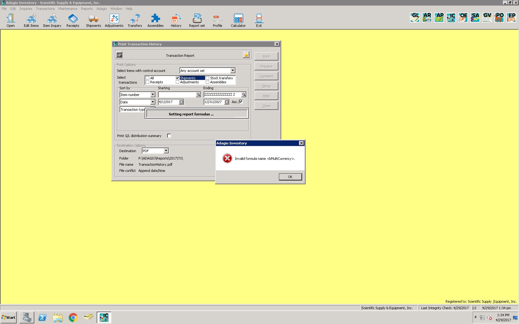

I've been getting this error when I try to print reports in inventory. Particularly the transaction history report. When I get the error it hangs up Agagio and I am forced to close inventory and reopen it.
Invalid formula name.jpg (111 downloads)

These sorts of formula errors in reports typically occur because the program, report and data dictionaries are not all in synch. There are no known problems with printing reports in Inventory 9.2A and invalid formulas.
What version of Inventory are you using? From the image you included, it is version 9.2A as from the logo, but the release date would be handy.
Do you use Adagio MultiCurrency?
Do you recall the last time you were able to print reports from Inventory successfully? What have you done since that time? Install any Adagio upgrades? Windows system updates just installed this week.
You may want to get in touch with your Adagio consultant, if you haven't yet already.

The version we are using is 9.2A (170608) and continue to get the <bMultiCurrencies> Error in inventory when trying to print transaction reports
We do not use MultiCurrency.
I am told this has been a problem since September or October of last year.

Using the same version of Adagio Inventory as you, and previewing the Transaction History report on sample data for just shipments (as you did) or other selections, I was not able to replicate a problem.
Are you able to replicate the same error in Adagio Inventory sample data? Just to confirm whether the issue is with the setup or the data.
If single-currency sample data also gives the same error, then these are the correct files that should exist on your system:
- \Softrak\Inventory\Inventory.exe dated Jun 5, 2017
- \Softrak\Dict\ files @N92AI.SSI and @N92AR.SSI both dated May 30, 2016
- \Softrak\Inventory\StandardReports\ICtransh.rpt dated Jun 24, 2015
If I edit this RPT file with the Crystal Reports designer program, I see a formula <bMultiCurrency> in the report, though I don't know exactly how it is used. It looks like a true/false variable.
And this report is based on a temporary work file, so a successful print of this report presumes that the data passes an integrity check, and this work file gets created successfully.
If you have a \Softrak\Inventory\ModifiedReports directory with the same report file ICtransh.rpt in it, this would mean that someone has saved a modified version of the Transaction History report for you. If the file date is older than that above, it is based on an earlier program version and would require updating with the new reporting environment. I don't suspect this is your scenario, but it must be mentioned.

I can replicate the error in the sample data.
The only file that doesn't match is the: \Softrak\Inventory\StandardReports\ICtransh.rpt dated Jun 24, 2015
It is date Dec 5, 2015

Since your report date is newer than what it should be, this means to me that either someone has modified this report, or some previous installation mis-dated this report, and a later upgrade or service pack was not able to overwrite this file with one that had an earlier date. In either case, this would appear to be the culprit.
If you have a \Softrak\Inventory\Backup folder and in one of the sub-folders, this ICtransh.rpt with the correct June 24, 2015 date, you can try replacing the wrongly-dated report with the good one. If you don't have this report file in a backup folder, then you should contact your Adagio consultant and they could do this replacement for you.
