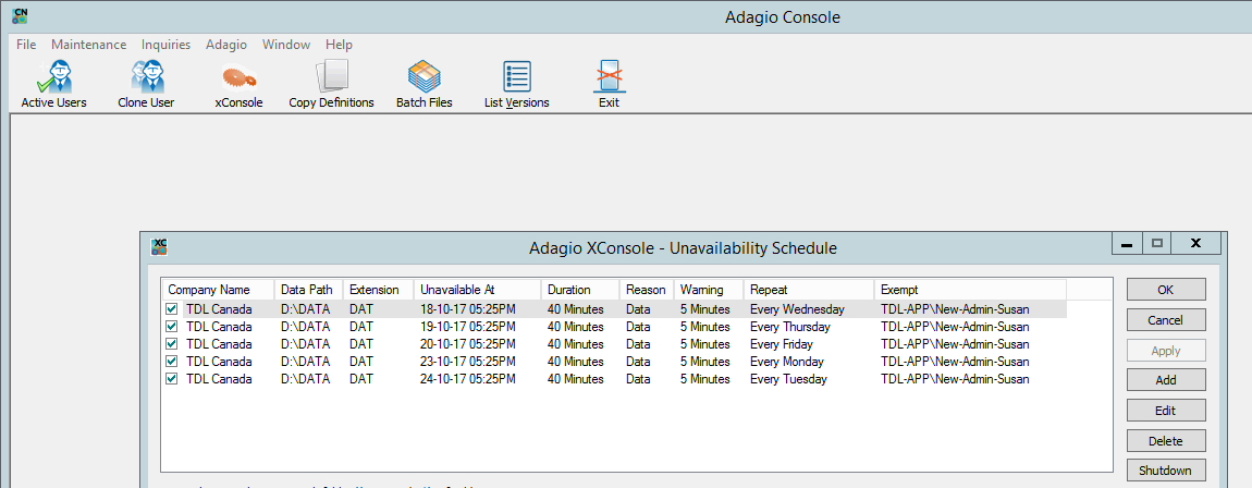

XConsole is scheduled every Monday - Friday evening (screen shot attached). However, when a user leaves Adagio open, XConsole fails with a message "XConsole Shut Down was cancelled". As a result, DataCare aborts.

5:25pm is shortly after the end of your day. Do you go into xConsole and adjust the shut down time if you are still working at that time?

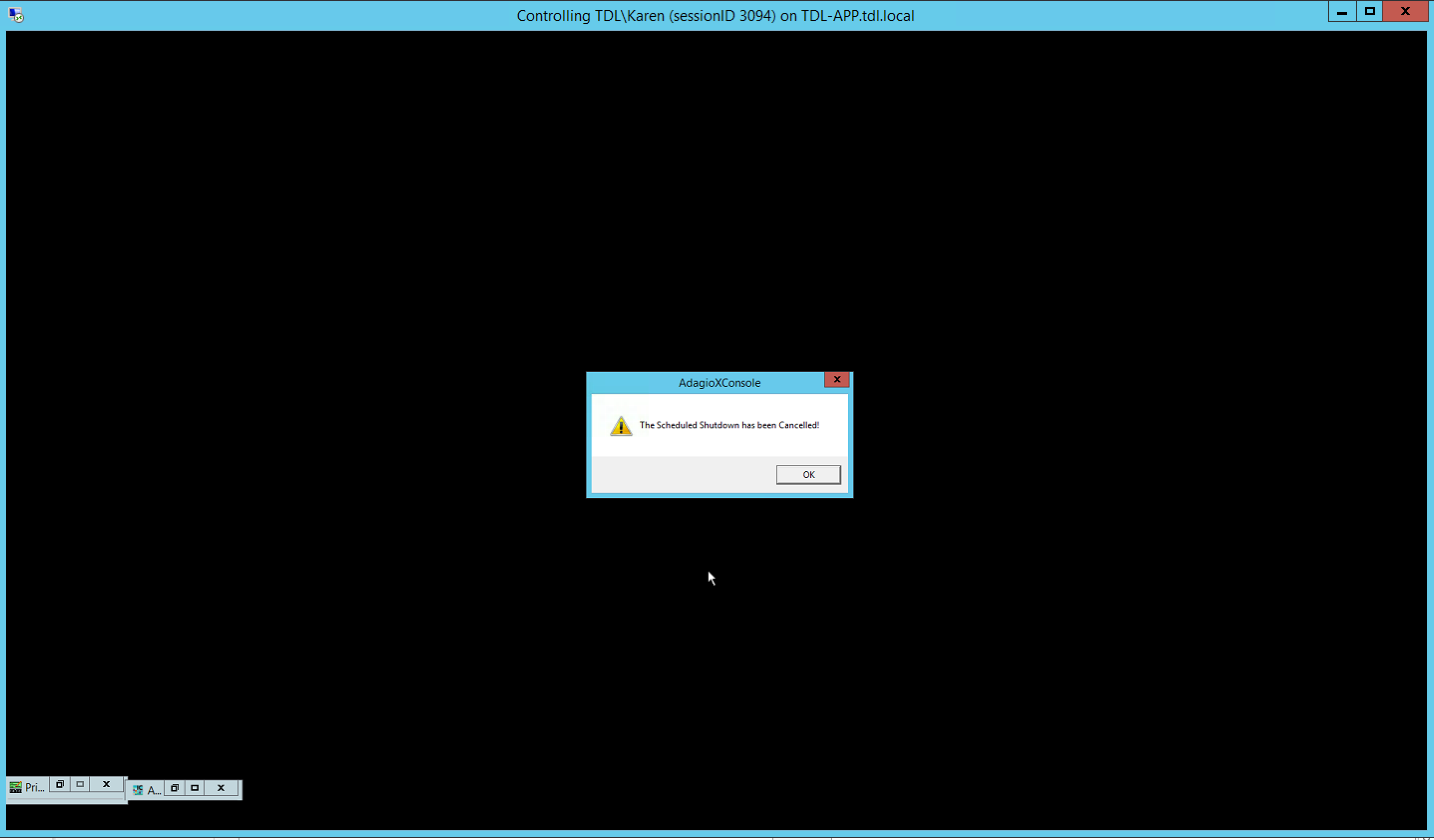

#55393 - 10/20/17 05:35 PM Re: XConsole Shut Down was cancelled [Re: Retired_Guy]
(107.190.5.43)
See attached screenshot.
Screen Shot 2017-10-19 at 6.58.36 PM.png (165 downloads)
