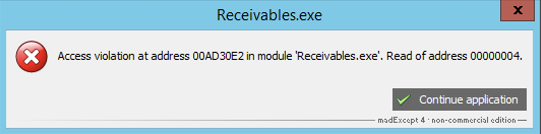

Hi,
We are using AR 9.3A (190821).
I am trying to recover 4 deleted cash batches in AR.
AR/Maintenance/Recover Batch/Cash
I can see the 4 cash batches with status "deleted". I can "Print Listing" on each one. However, when I click "Recover" I get a message, "0 batch(es) were recovered" followed by an access violation (screen shot attached).
I have tried multiple times and always get the exact same error. Can anyone help?
Screen Shot 2020-05-31 at 12.03.40 AM.png (38 downloads)

Those messages are difficult to resolve because there's little usable information. You are using the latest version - there is no newer service pack or hot fix. Let's rule out a data problem: Does the Data Integrity Check show any problems?

When you received the error, were you always trying to recover the same batch? Do you get the error on all 4 batches?
I'm using the identical AR version. I can Recover a deleted batch in Sample data. What happens if you try the Recover function in your Sample data?

I tried all 4 batches and they all have the same error. I opened some back up data from Feb and recovered a deleted cash batch. It worked great.
#64043 - 05/31/20 06:24 PM Re: Recover Deleted Cash Batch in Receivables [Re: SusanTennier]
(198.84.146.121)
I can also recover other deleted cash batches in my live data. Just not the 4 I want. There must be something unique about them?
