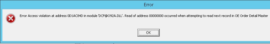

The customer has encountered the following problem:
Adagio DC stops at this point (see pic #1)
And displays the message 2 times (see pic #2). After clicking OK DC continues to run and shows no errors when it finishes.
When DC is running as scheduled task, it will lock the task and will never finish
because the modal dialog will never close.
How to fix this problem ?

Hello Vlad,
You are running a pretty old release and there is not much information here.
Please try running integrity check through OrderEntry.

As suggested, try OE DIC. If the problem is some record with invalid data, it will be a problem for DC or OE to correct. My guess it's an amount field or something it uses to calculate a field. For example, MC or number of decimals. Try using GridView on the Order Detail file and see if some record has an invalid data. Sort by various columns to see if the problem appears as the first or last record. Then use GVRW to correct the problem.
